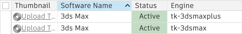

In order for the new engine to be usable from the Flow Production Tracking or the tank command, you need to make sure there is a Software entity in Flow Production Tracking configured for the tk-3dsmax engine. To do this, visit the Software page on your Flow Production Tracking site. If you are a Flow Production Tracking administrator, you can access the page by clicking on the user icon at the top right of your site and selecting Software. You can then create a second software entity named 3ds Max with the Engine field set to tk-3dsmax.
_images/software-entity.png
However, doing this means that both engines will now be active for the out of the box integrations. By using the Project field, you can restrict which project uses the tk-3dsmaxplus engine and which project uses the new tk-3dsmax engine in order to avoid disruption in production. If you are not using the out of the box Flow Production Tracking Integrations and plan on having only one of the two engines in your Toolkit configuration, you can duplicate the 3ds Max Software entity and update the Engine field without having to worry about assigning projects.
